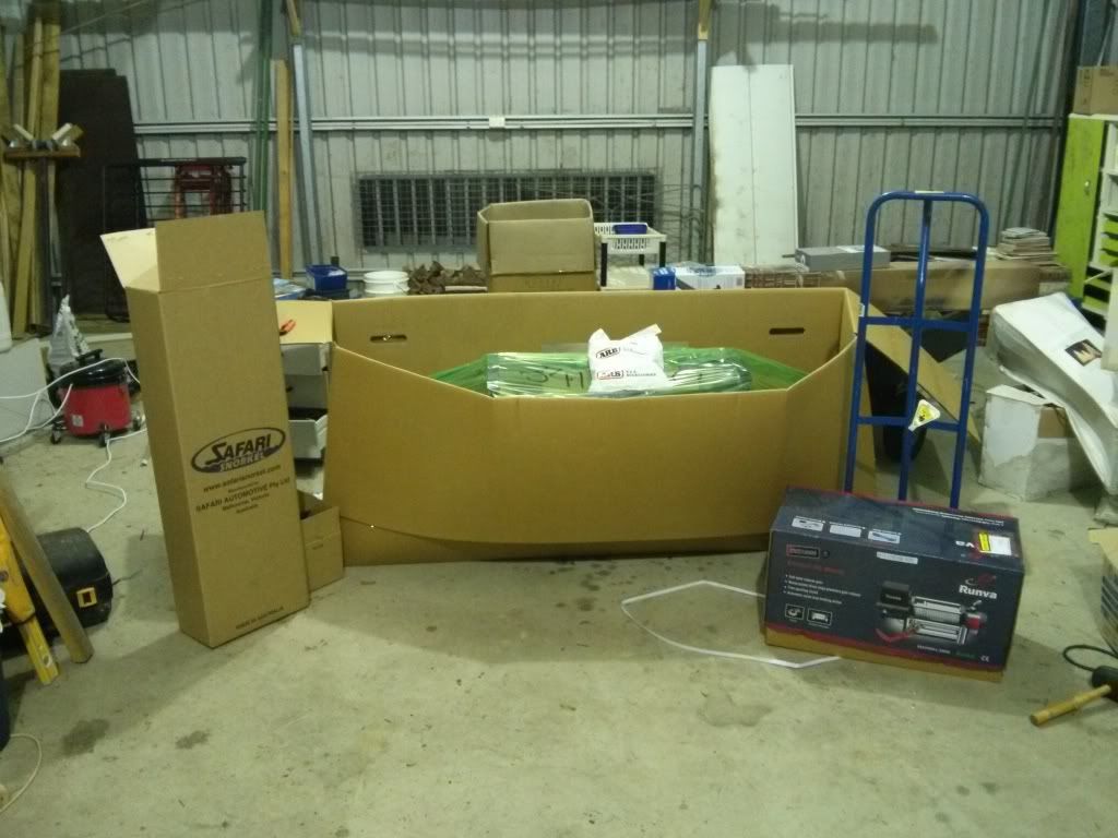

It started with a few boxes

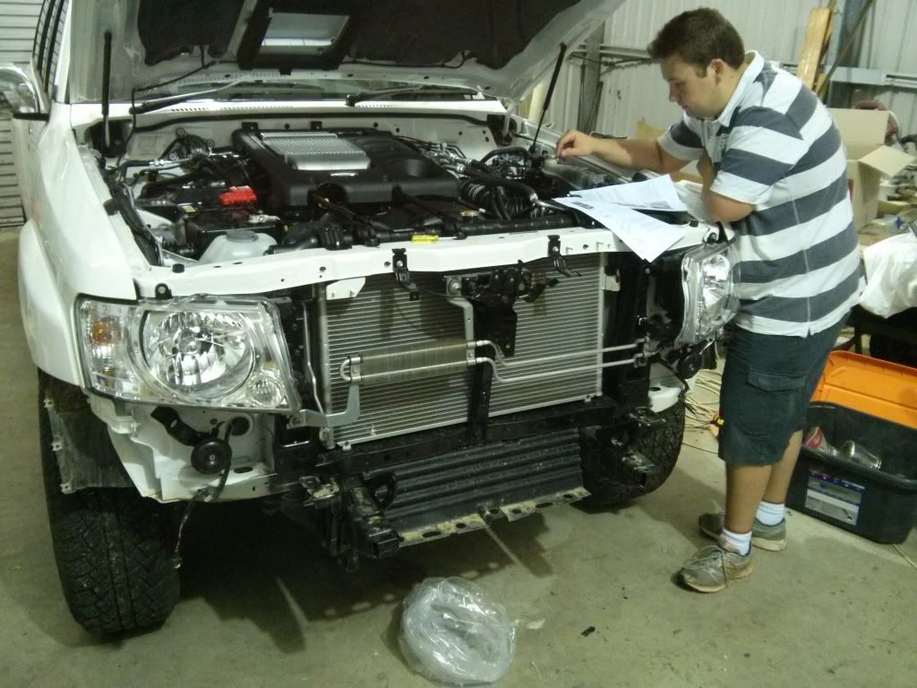

The car got half naked, and in a rare moment Greg was caught consulting the instructions.

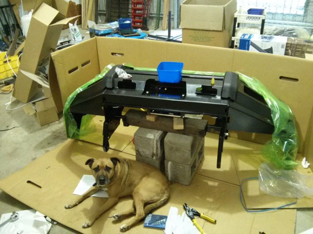

The bar almost ready to go on and Pep-C was keeping a close eye on proceedings.

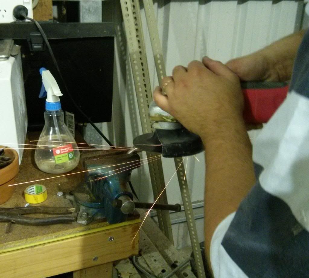

Some "customisation" of the winch clutch handle was required

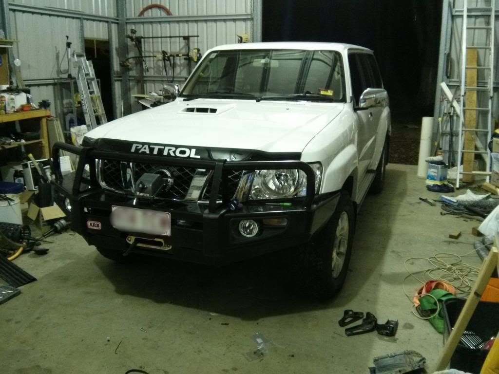

And the final result - a new ARB bar and Runva 12000 lb winch. Unfortunately the Safari snorkel is still in the box, waiting for another day.

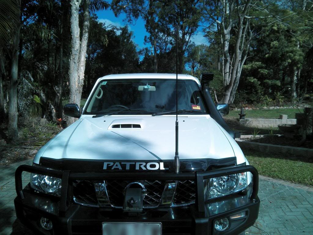

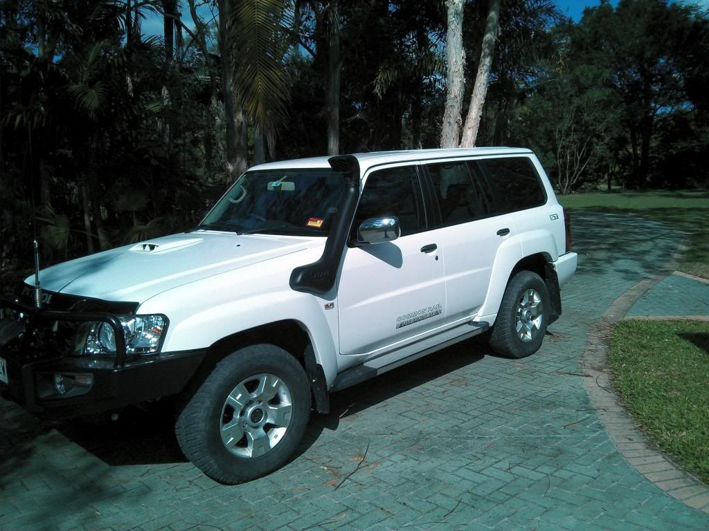

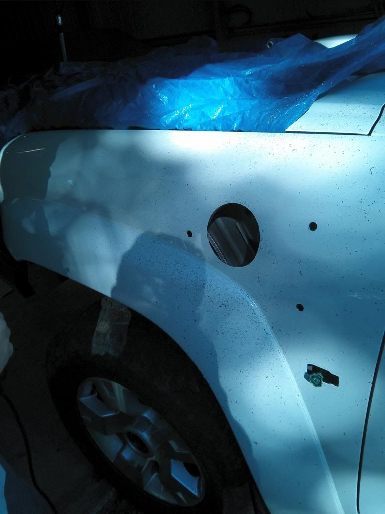

I now have the radio and aerial installed and got the Snorkel on with Greg on Saturday.

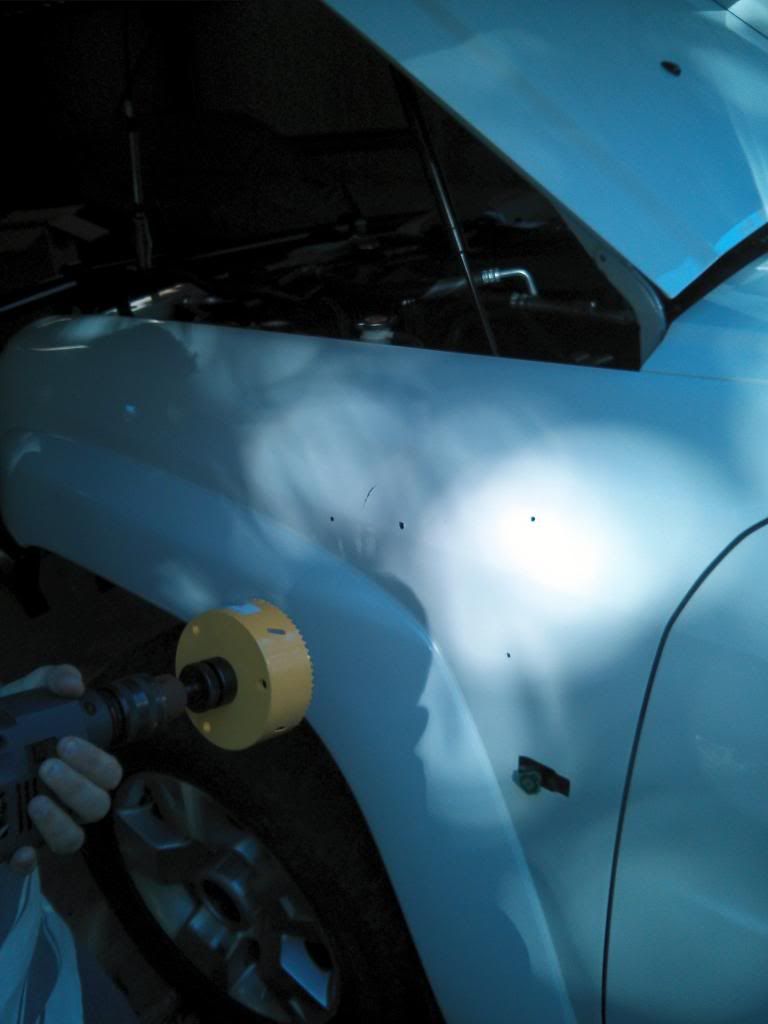

There was a little hiccup in the installation of the aerial with the instructions being incorrect. They stated that for the 3L engine (the same snorkel is used for the 3 and 4.2 diesels) that only one hole needed to be drilled though the guard and for 4.2 L another hole is drilled through the inner guard. I can now confirm that the later model 3.0 L also require a hole through the inner guard. So in the end we needed a 108mm (got away with a 105) and 95mm hole saws.
Some pics
And the end result
