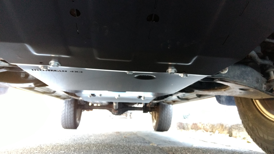

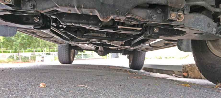

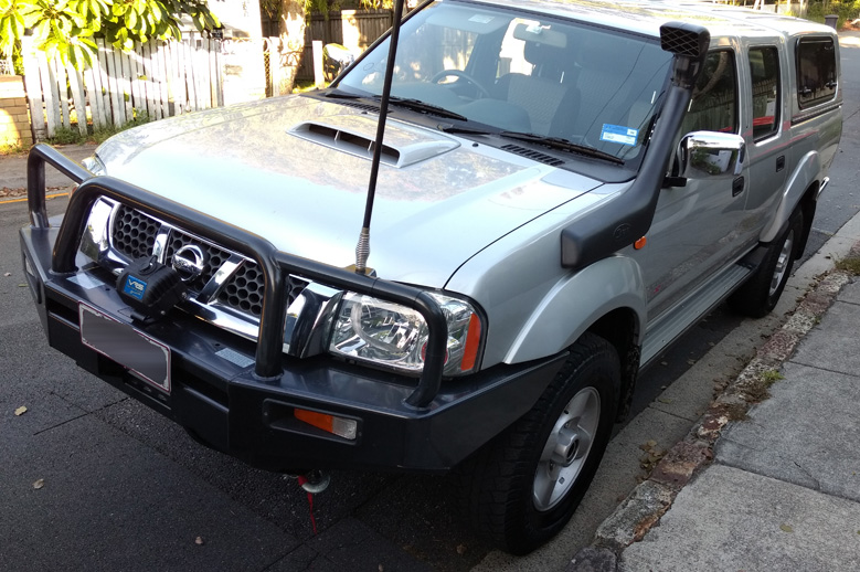

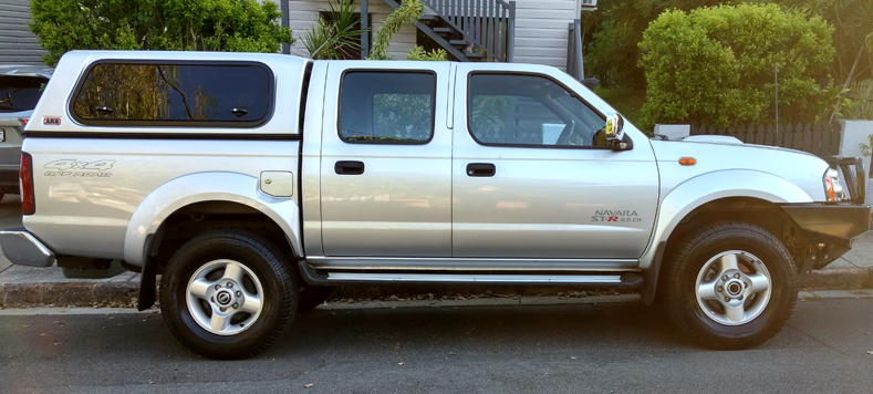

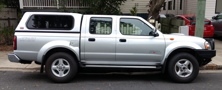

G'day,
Here's a few before & after photos of the work I just had completed on my Navarra. I had a 2 inch EFS lift kit fitted, an Eaton Harrop rear E-Locker installed, a Safari snorkel fitted and a VRS 9500lbs winch installed too. It was going to be an Ironman winch but the control box was too big for the factory bullbar so went with the VRS which has a smaller control box.
If anyone is free on Sunday to take me out to Glasshouse to try out my new locker I'm keen.
My Navarra before its 2 inch lift.
My Navarra after its 2 inch lift.
My Navarra before the bash plate
My Navarra after the bash plate
My Navarra with winch & snorkel fitted.
Re: CBM_64's Navarra
Hi Cos,
It looks like a real 4x4 now. Don't the bash plates make a difference. I'll happily make a trip to the Glasshouse mountains. I haven't been there for a long time.
Very nice, now it's looking the part! :)
You'll be itching to test it out...
