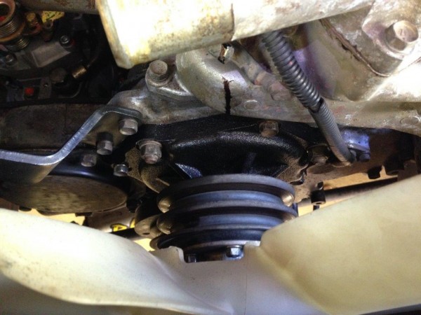

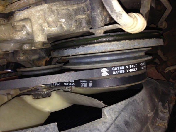

One morning I noticed a little green radiator leaking on to the ground. I went searching for the source and found it was coming from the from of the Water Pump. I ordered a new water pump from Patrolapart and installed it a week later. The bearings in the old one were certainly not in good order.
Leaking Water Pump - looking from underneath
New water pump - Looking from the top
